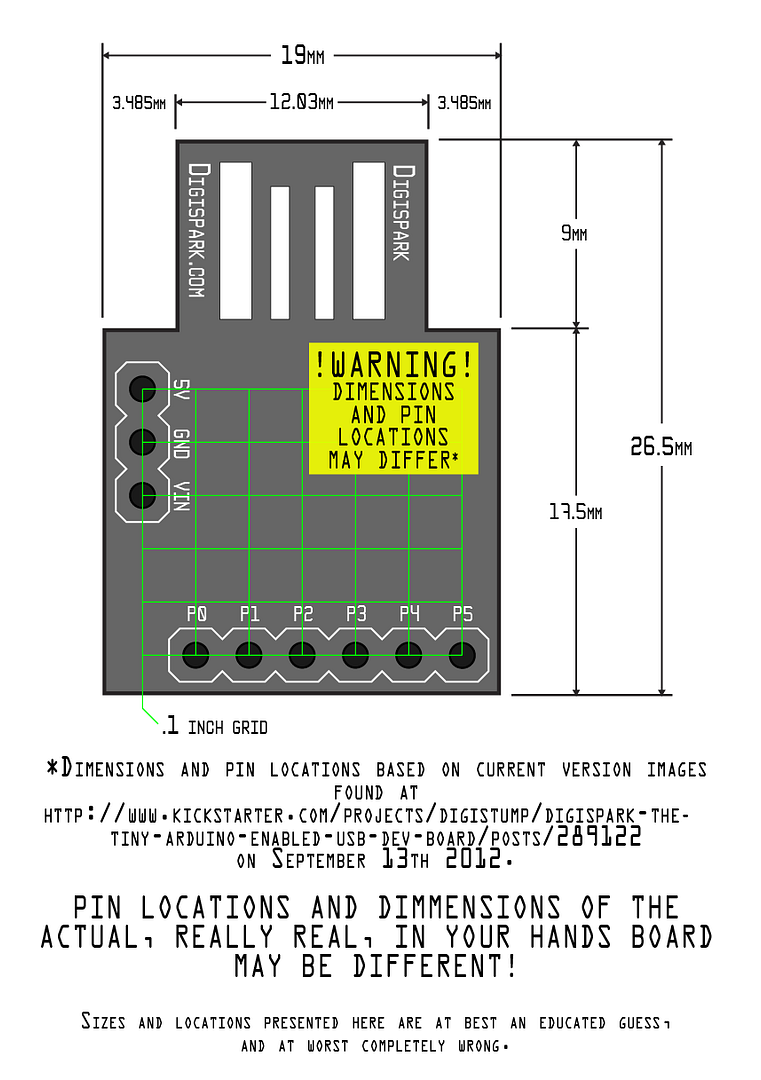

Smolder
  • Posts: 4
Could really use some pinout / functionality information
« Reply #4 on: September 21, 2012, 06:30:26 am »
I\'ve been really excited by this as well, excited enough to make some wild speculations. I worked up this guess as to the digispark footprint. This is just my own guess based off of the currently available images, you should in no way use this as a reference or base anything off of it. I\'m going to, but you shouldn\'t since I could easily be totally wrong.
http://i795.photobucket.com/albums/yy232/smolder_bucket/DigisparkPCBLayoutv10-01_zpsc415f306.png
