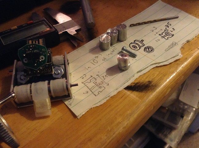

We have had the lathe out a bit and have started to play around with dimension we need for the wheels.
I Was going to do them last weekend but turns out I had started on them again today at work.
I brought the lathe home though as I need to find a better setting to lathe in.
I have four little shiny pieces of bar stock cut out for wheels. Just need to shape them up. I started one today but then moved the lathe.
Hoping to have them finished by the end of this week or during the weekend. I always get stuff to do after work... work is the best time to work on robots lol.

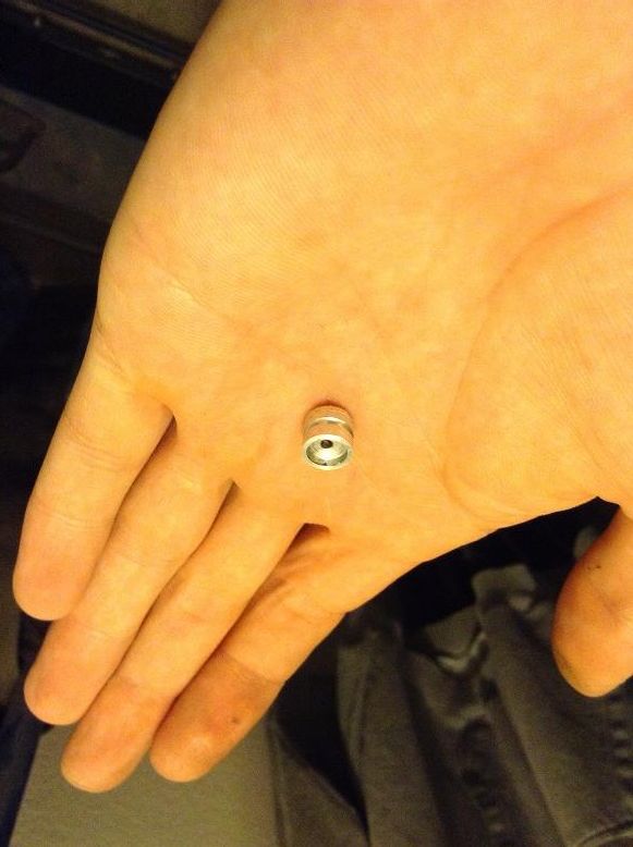

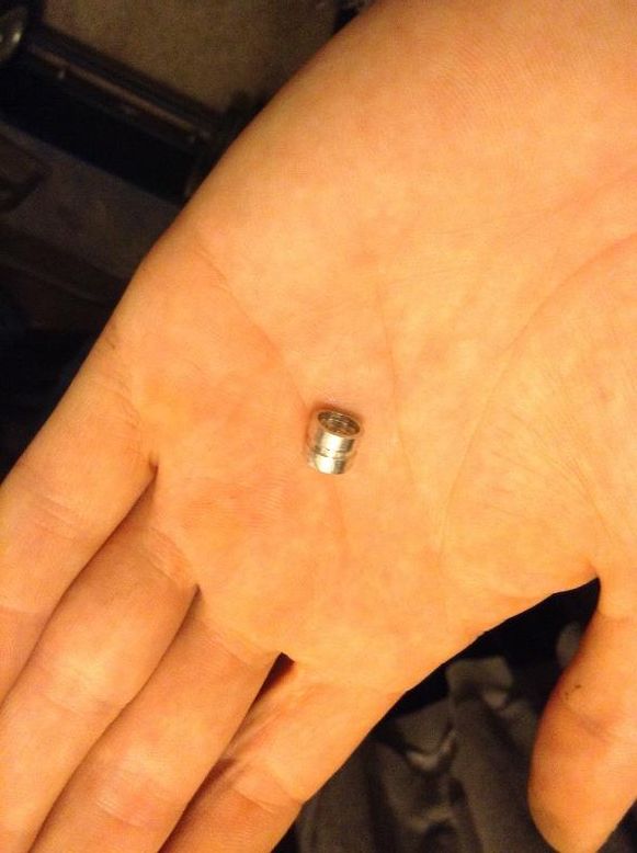

I made one of the wheels today! .. but I drilled the hole off-center!  :-[ Also, when I clamped the wheel to drill the hole, my clamp chewed up the wheel.
So from now on I'm going to drill the hole first in the bar stock and then lathe the dish wheels down and finally the rubber band groove in the center.
So the first wheel was a learning experience. The next four might look and go a lot smoother if I can get the hole centered in the bar stock initially.
Here's the first wheel. More to come. This is gonna be sweet when they're all done!
