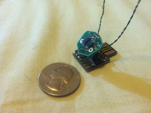

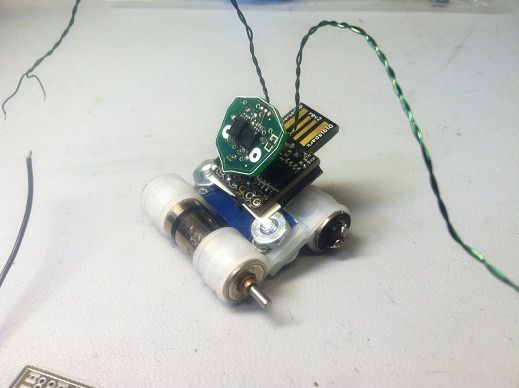

I then added a custom three pin requirement pwm h-bridge motor shield to one of my digispark.
I think it seems to be working properly. Looks like a head of a robot.
More to come. I tested some motors and need to build a gearbox and motor set.
the two pair of wires coming off are for the motors. There is three I/O left for peripherals.

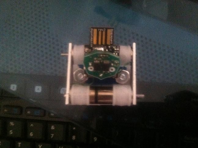

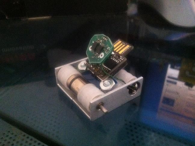

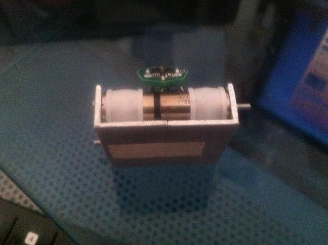

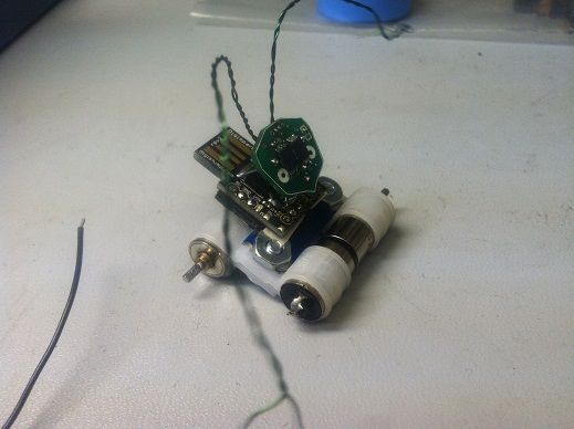

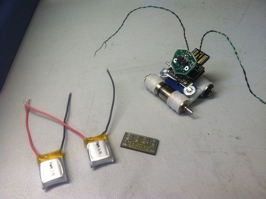

small amount of progress on the chassis today, even started installing the brains and brawn of the operation. Have some batteries and some other peripherals to go on next, including some wheels for rubber band tank treads I may lathe up if I can get away with it at work or something.
I've had these Swiss geared motors for ten years now... since Robomax in Oregon. Finally found a use for them. lol
The batteries I got last time for my other robots were smaller and even came with charge/discharge protection. These batteries are larger and have no added circuitry. I got ripped, but oh well. I'll try and use them anyway. Little fire hazards.
There's the line sensor PCB I will likely put on this robot eventually, if not a larger one.

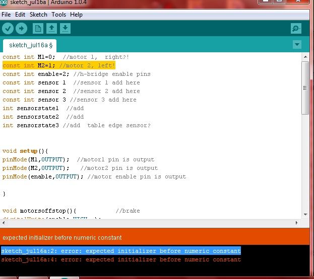

why did this code work yesterday and not today?
I'm getting an error "expected intilializer before numeric constant"

My first thoughts are how did it work yesterday.
You need some semicolons after the const int sensor lines.
I don't suppose it might have defaulted to the wrong board and programmer??
Mark
caseyjholmes

« Reply #8 on: July 17, 2013, 05:24:18 am »
Oh, sheesh!
Talk about a newbie mistake.
Ok thanks  :o  I should have seen that one coming.
Board and programmer was right, my code was wrong (as usual!)

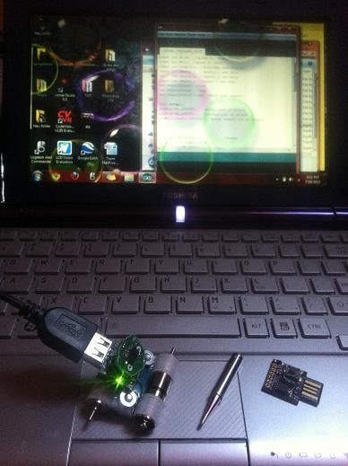

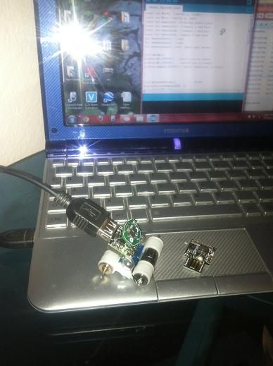

So I have the motors wired up and tested.
Pretty neat driving a couple small high precision motors via USB like that.
I may try and make a small low power robot arm one of these days with USB control. That would be neat.
Well here is some pics with the robot plugged into a USB extension cable for programming and the motor wires terminated and tucked away.
I just moved into the new place and started unpacking my tiny lathe so I may get a chance to do the wheels soon. HAd a bit of a break there and haven't done much other than test the motors and PWM H-bridges to the basic program.
I want to learn how to remove the delays next.. along with finish the hardware part of the chassis.
Then the batteries and USB charger come last with the sensors.

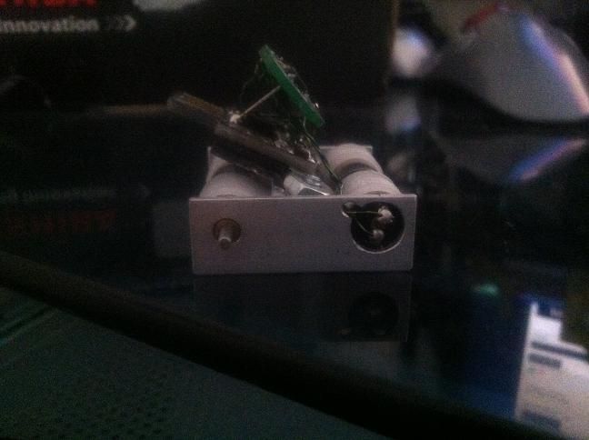

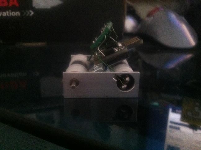

Assembled the battery last night.  Waiting on a lipo balance adaptor so I can balance the battery while charging, then I can mount it in the robot.
Unpacked the lathe but still pretty busy.  Not sure when I'll get to it..
Next on the list.
I could also benefit from a digispark programming tool here pretty soon..
I had an idea of making the robot respond to direction keyboard presses from the PC.
Ill have to look into that.

OK here's an update as promised.
While at work I managed to get the robot chassis complete aside from the pulley wheels. I will have to make those on my lathe, or steal them from a toy or something and shape them as needed. Likely use my lathe.
I plan to put four pulley wheels on the robot. One on each extreme lower corner of the sidewall chassis we made at work.
Then I need to more pulley wheels with set screws to slip on the swiss motor shafts. I'll use rubber bands for tracks, since that has seemed to work so well in the past on other robots.
I have the batteries but haven't figured out how to install them in a neat way just yet, along with onborad USB charger.
I'll get to it. I'm gonna put some thought and time into this robot.
Here's some pics of the progress. The side aluminum channel was perfectly cut to length and positioned on the robot around the motor bell and motor oilite bearings/bushing for a perfect fit, then a channel was dug for the wires coming off the endbell.
Love the looks.
