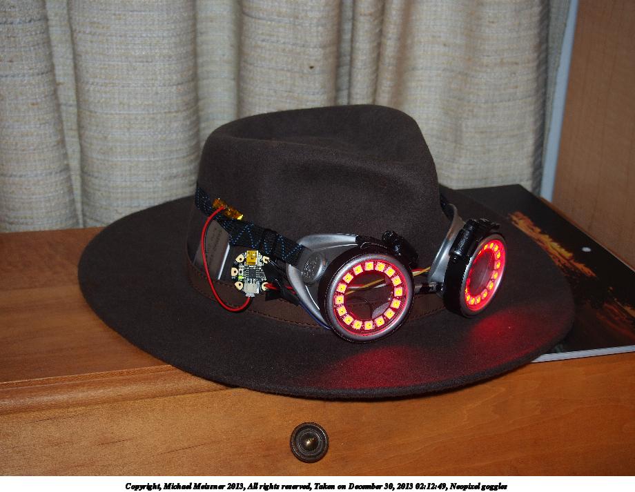

I like to use Adafruit neopixels (ws2812b based LEDs) that are fairly picky about voltage (3.5-5.3v).  I blew out one of my Digisparks, when I attached the VCC line to power two 16 LED neopixel rings (I was powering it via USB).  Now, I keep the voltage low (typically ~ 75mA) by limiting the power on each led to 30 (sum of red + blue + green power levels).  Evidently it was too much for the Spark.  Other micro-processors that I use, have had a big enough regulator, that small amounts of lights are possible from the 5v pin (or 3.3v if the processor is 3.3v and I'm powering it from a li-poly battery).
Assuming I'm powering the Digispark Pro via a USB port (i.e. a phone charger battery), would I be able to plug into the VCC line?  If not, if I'm powering it via USB, does VIN get 5v in this case?  I assume that since the Pro has a 500 mA LDO regulator, it would be safe to use VCC if I'm putting 6-16v to VIN, but it isn't clear about the case when it is being powered by USB.
On the Uno, the 5v pin by-passes the regulator, so you get as much current as the USB connection provides.  On the Teensy 3.x, there is a 500mA regulator between VUSB and VIN, which is ok for my use (but the 3.3v signals need to be level converted if you use 5v power).  On the Pololu A-star LV, the step-up/step-down regulator can provide up to 1A of 5v power.  On the Gemma, VOUT gives you the direct power before the regulator, and the 3.3v pin gives you 150mA of regulated power.  On the Trinket, you have a pin that gives you the USB power directly, and you can draw up to 150mA directly.
I know when you power hundreds of lights you need to pay more attention to power issues.  But for just a few lights for a wearable costume, having to have 2 power sources, is a drag.

Fair enough, I tend to see the world through a software lens, and I'm sometimes hazy on the electrical details.
I realize you can't get assume you can get more than 5v power at 100 mA or so from USB.  What I'm trying to do is realize how to hook things up so I can use a single power supply and drive both microprocessor and a small number ws2812's (32 in my case).  Yeah, I should have in the description put in 5v whenever I was talking about mA.  In any case, I limit the power of the ws2812's so I can power 32 leds at 5v with 70-80 mA of power, which allows me to use USB to power the setup without additional batteries.
On the Teensy I can hook up a li-po battery to vin/ground, and connect the leds to 3.3v power, and things will work.  Or I can hook up 5v power either through the USB or through vin/ground and use a level shifter to get the data communication to 5v.
On the Gemma, I hook up a li-po battery to the JST connector, and connect the rings power to the Vbat pin.
On the Uno, I need to use a USB cable to provide 5v power from a phone charger battery, and I hook the rings power line to the 5v circuit.  Or I use 7.5 - 9v power via the 5.5mm connector, and still use the 5v pin.
I'm trying to understand how I would connect up a Digispark Pro.  If I use USB power, I presumably could use the VIN pin to power the ws2812 leds.  But if I'm powering the chip via the VIN pin, and it is more than 5v, can I use the VCC pin to power the neopixels?  Most of the time, I will be using the li-po shield, but one of my planned setups uses 9v for other things, and I would want to hook up the Digispark Pro to the 9v.
As I said, with the original Digispark, it blew the fuse when I tried this setup, and I wanted to make sure I could set up the Digispark Pro with a single battery (preferably a USB phone charger battery).  If I can't do it simply, I likely will use the Digispark Pro less, and use other processors more.
