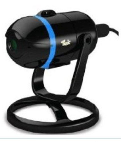

Rather than trying to go through the microcontroller, you could use a camera that does its own communication. Like the AI Ball:
http://www.amazon.com/gp/product/B00AYO96I4/ref=as_li_tl?ie=UTF8&camp=1789&creative=390957&creativeASIN=B00AYO96I4&linkCode=as2&tag=geekramblings-20&linkId=6NKED4XQJAOQVBAI
This little camera does wifi video streaming all by itself.

You can try products like: http://www.adafruit.com/product/397, but you will realize, that integrated solutions, like dougal posted, are much more reliable.
