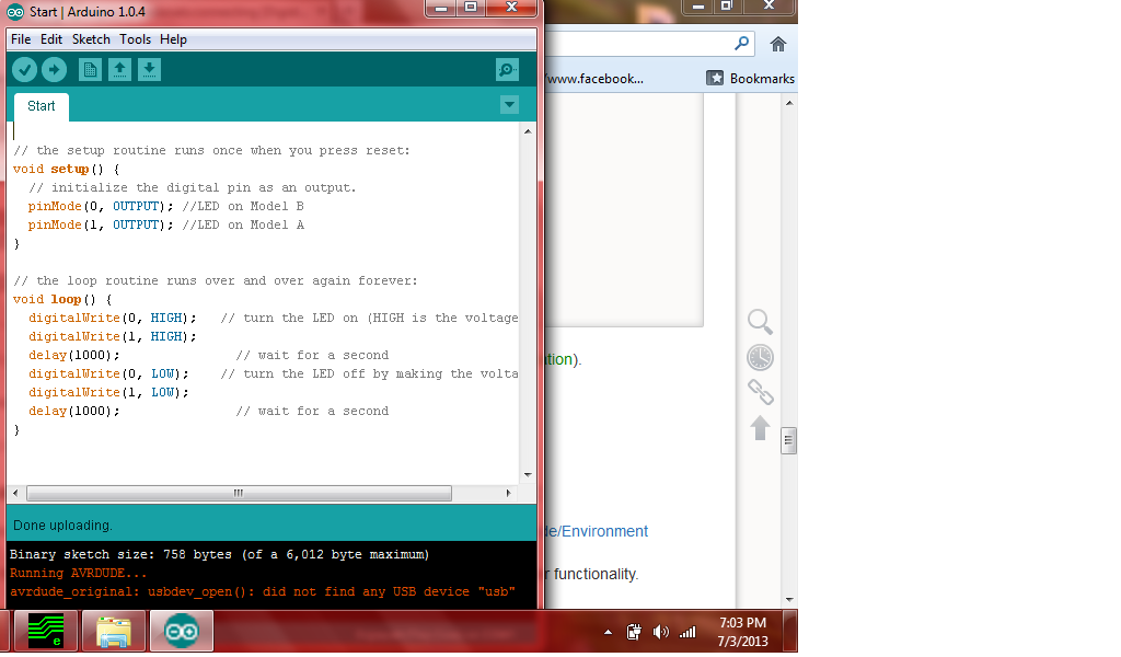

I get this error shown below with the Windows 7 laptop..
the driver installed and the laptop recognizes the digispark as digispark bootloader but there is still this error when trying to download test code:
It gets this error regardless of if the digispark is plugged in or not when I compile/build.

« Reply #10 on: July 03, 2013, 11:57:21 pm »
You need to select Tools->Board->Digispark and Tools->Programmer->Digispark
caseyjholmes
  • Posts: 25
Re: IDE will not recognize DigiSpark
« Reply #11 on: July 04, 2013, 06:06:37 pm »
..and it worked!
Thanks!
